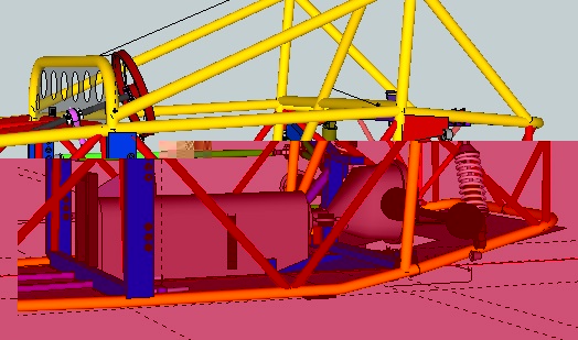

I've been going thru the SketchUp drawing and duplicating the tubes with bends onto a separate area of the drawing with a grey background and attaching dimensions to them. These parts match the ones in the car and they and their dimensions change automatically with any final adjustments to the drawing. I also attached revision numbers and dates to them. Steel is on the way and the bending will commence in a few days!
One last change suggested by Charlie was to kick up the bottom chassis rail just before the main roll hoop to match the transition from floor to diffuser. It's going to weld up better this way and looks a bit nicer too.
It's looking to be just a few hundred dollars for the roll cage and basic frame tubes with bending, if anyone is interested in a set. There is no profit here, just the cost of the tubing and labor.
I would like to point out again that this project is an "Open Design", so please contribute your thoughts! This means you are not locked into a vendor and one designer's opinion on how to do things. There are multiple body styles available already. There is a lot of work that has gone into suspension and chassis design and a great deal more on the way. No kits offer this combination of possibilities, the performance potential and tuning options are enormous... In some sense a conventional kit is more complete, but you get to apply the profit made by a kit manufacturer towards getting what you really want from your own efforts and/or the efforts of local fabricators you choose to support.
- Car9Gstab47KickupB.jpg (80.25 KiB) Viewed 38697 times

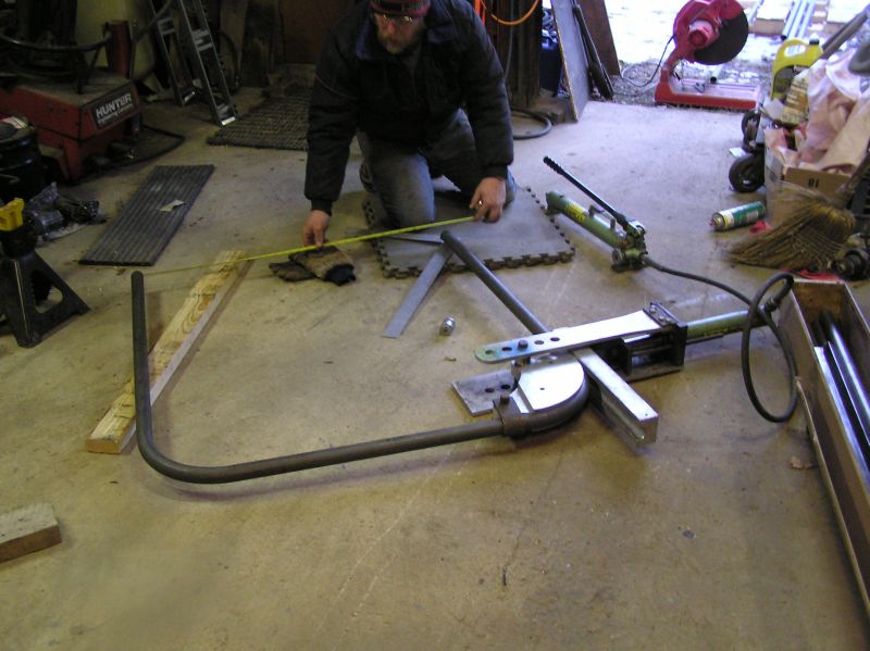

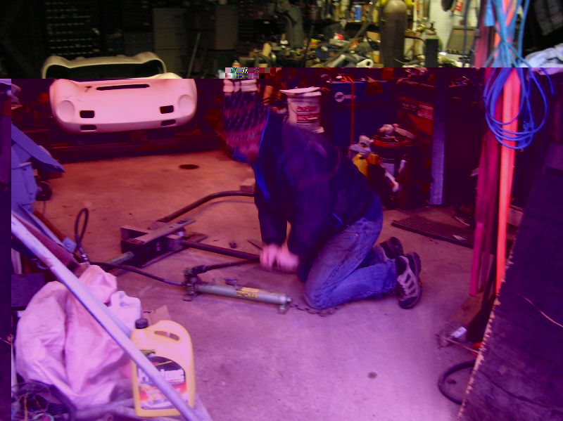

So we're not off to the races yet, but we have got to the "feet wet" stage. Charlie North put up a couple of pictures on the LocostUSA site showing the start of tube bending for Car9. This is the first tube being bent, it's the main roll hoop and is going to a gentleman in Seattle. He built an Ultima a few years ago and it's such a nice car he finds he babies it. This one will be a different story.
The second set of tubes will be for my car and there is a possible third set on order too.
You'll notice in the back of Charlie's shop is an Elva body, a very pretty vintage sports racer. COM may land up being a vintage sports car club one of these days, at least if you want to go fast
- Car9MH1.jpg (91.03 KiB) Viewed 38654 times

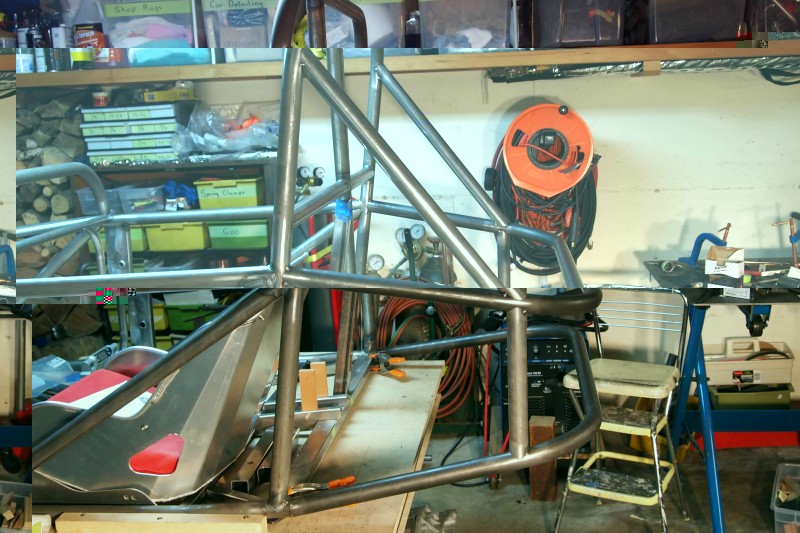

Some more progress pictures, almost starting to look like a car. Here we have the rear hoops and a support for the main roll hoop rear braces. Also the inner dash hoop and a diagonal inthe footwell.
- Car9Frame6.jpg (162.61 KiB) Viewed 38532 times
- Car9Frame5.jpg (142.1 KiB) Viewed 38532 times

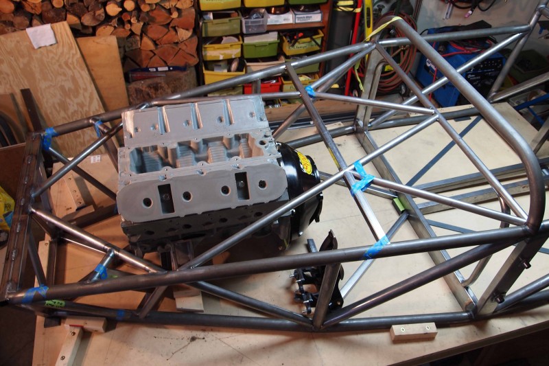

Hi David! Maybe we'll talk, I'm still trying to figure out what to do. I didn't explain well the fellow in Seattle is a co-builder. He got his tubes for the cage bent and shipped to him. He is now well along on the frame. Here's a couple of nice pictures.
- Tom_030.jpg (132.89 KiB) Viewed 38300 times
- Tom051.jpg (133.16 KiB) Viewed 38300 times

Yes, Tom is doing great work filling in the frame. We both bought our bent tubes from the guy who was doing the welding on my cage. Tom just got the tubes shipped to him. I wasn't happy with where the guy doing my work was putting holes in the frame for suspension mounts and then I had a mistake in my drawings for the angle of the upper rear facing hoop. I guess he got frustrated.
I think Tom would be well ahead of where he is now if my frame was ahead of his, which was the intention. The main hold up was finalizing the tubes that are within the main roll hoop for the rear suspension and diff mounts. I have learned again that the last %5 of a project can take a lot of time. I'll post some pictures of where that stuff is now, but it will probably take a day.
This was made harder because I didn't completley understand the rules for cages in tube cars. The main roll hoop doesn't have to extend to the floor, just to the frame which in this case is by the driver's shoulder. So it would have helped if the tube from the driver's shoulder to the floor could kick forward just 3 inches or so. It gives more room for the lower contgrol arm and move the inner attachment of the upper link backwards a bit. I think I will draw that up and see how it looks. Otherwise I'm pretty happy with how it turned out.
I'm not really thinking of making a tube kit, but the drawings and parts lists and our build logs are all available for people to look at and use. If the car runs well, it would be fun to offer a tube kit... I love those videos of laser tube cutting machines. They can do perfect coping and then even label the parts for you with arrows and directions!

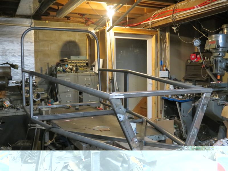

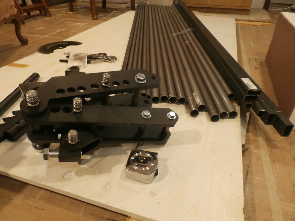

What can I say, hope springs ever eternal… Going to start this thing over from scratch.
This is what I wrote for the build log on my LocostUSA thread:
So here is an official start of my build. Feel free to pull up a lawn chair, watch and even have a drink. My only warning is that if you choose to watch, you may land up laughing so hard you need a change of clothes. If you're lucky it's because you spilled your drink, our audience is a friendly bunch and there will always be more.
My frist thought after carrying in all the stuff in the picture is that steel is heavy. Steel is so heavy in fact that it weighs hundreds of pounds. There may be a follow up order to obtain littler bits. All the material was purchased over the web from Online Metals and delivered to my house.
My garage is full of stuff and it was dark outside so the material got carried to my basement. It's warmer there so with impending winter the car may get built there and then I could jack up the side of my house to get the car out. Or cut a hole or something but I think looking forward to too many problems will just just slow me down, so we will go at this a few days at a time.
- Car9G_01_01sm.jpeg (154.85 KiB) Viewed 37917 times
