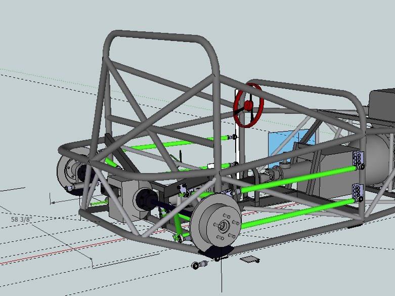

Here is a picture of the rear of the frame. My first questions are about the legality of the roll cage. The upper rear braces for the roll bar are at the required 30 degree angle backwards, but I can't tell if it's allowed for the two braces to meet in the center of the back. The other question is wether it's OK to tilt the main roll hoop a few degrees. Even 5 degrees would help me a great deal. I don't mean extra or out of plane bends, just the whole hoop tilted 5 degrees.
I have worked hard to design the rear of the frame to not have tubing around the IRS that would intrude into the passenger compartment in an accident. I was surprised during the modeling how important the tubes behind the driver were for stiffness, The two little tubes under the middle of the rear hoop contribute 30% to the stiffness of the whole car.

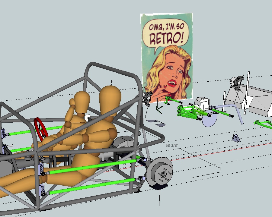

Here's another picture with a driver. I realize I haven't really given any background or even dimensions yet.
I am drawing the project in Google SketchUp. I don't know if that is the best choice, but it is free and available for both MAC and PC. I keep a copy that I update in the Google 3D Warehouse, so anyone can download it and play with it and even improve it and upload. SketchUp supports "layers", a way to stack or enable/disable different parts of the drawing. There are 15-20 layers so far and they include different parts for the suspension, a Ford Duratech and a V8, Subaru and Ford Thunderbird IRS, driver, some bodywork etc. I'm either indecisive or perhaps this will help other folks who want to draw their project,
I originally drew the car as 40" wide, but a friend wants to build a V8 version so I made it 44" wide. The nose is about a foot longer so I think the proportions are not too different. Wheelbase is 96" now, but can get 2-3 inches shorter if I tilt the roll hoop.
It's not drawn in, but the cage would need appropriate padding around the passengers. I drew the passenger as a lesson in fractions for my son. I'm not sure if he's scared of my driving or embarrassed to be seen in public with me!
Just like a real shop you can see the mess cumulating in the back corner. :)

I meant to answer this with the post above, it seems the driver fits but I am finding it's hard to tell some things from drawings and pictures. Last time I was at the track, Les let me sit in his car but it's still hard for me to picture. Maybe I need to mock up the cockpit a bit with some scrap wood.
The thought is to design the car for the track without compromise. It will still basically be as useful a street car as a Super Seven / Locost. Then if someone builds this and decides on some compromises for street use, that's possible. You could leave those forward braces off or add curved braces outboard of the current frame.
Here's a picture of the frame being modeled in FEA ( Finite Element Analysis ). This type of software can calculate the stress and strain of every tube in the frame in response to a load. I use this to see how much the frame twists and how stiff the suspension attachments are. This turned out to be a lot of fun and a good deal easier to learn then the drawing software. It was also very frustrating. One of the basic ideas was to get a stiff chassis by making the sides tall, so the forward braces of the roll bar connect into the upper chassis rail in a strong place and the upper chassis rail is taller. This is like a modern Formula Ford. It turned out though that the main roll hoop warped under stress. So the way the rear bracing for the hoop worked out was crucial. Effectively the rear braces come together in a pyramid shape at the back and they provide a huge boost in stiffness.
In the FEA software you can tell it to virtually clamp some locations of the frame and apply loads on other places. In this picture the front suspension mounts have been fixed and also the rear center of the frame is on a pivot. Then a vertical upwards load of 1000 lbs. is applied to the main roll bar on the driver side and a vertical downwards load of 1000 lbs. is applied on the passenger side. I picked the load because it's a nice round number and is also more then normal use. Currently the frame flexes by about 0.177" or about 3/16".

Here's a new picture following some suggestions I received. It's been a little slow because my computer dies, had to borrow a machine, restore backups reload software and learn how to use Windows etc. I'll have the old machine running again later today or tomorrow and be able to pick up the pace again.
In this picture I have been able to make the rear braces face much more backwards and they do not share a node anymore. I hope some tilt inwards will be allowed because there is no car to attach them to if they go straight back. The main roll hoop and suspension bulkhead have been tilted backwards by 8 degrees. This has let me move the rear suspension forwards by 2-3 inches so the wheelbase is getting down to 92"-93" and we're getting some more weight on the rear wheels. I think we can use as much weight on the rear as we can get.
I also drew in some more realistic mounts for the forward end of the rear suspension trailing arms. The front hoops lower legs are reinforced with some 1x2 rectangular tube in this area.
I haven't done the FEA modeling yet but will work on that next.
This picture is still using the rear suspension from a Subaru - R160 diff, halfshafts, spindles and brakes. I think that's a good choice for moderate I4 engines. Things like Ford Duratech are only something like $500 in junkyards and are good for 140-180 HP without having to open them up.
I'm going to start using some Ford IRS parts in the drawings now to see how they work out. They are also very common and available new from the Ford Motorsports catalog. The variety of diff parts (gears and LSD), halfshafts and brakes seems attractive. The problem may be getting small enough parts. The diff weighs only a few pounds more.

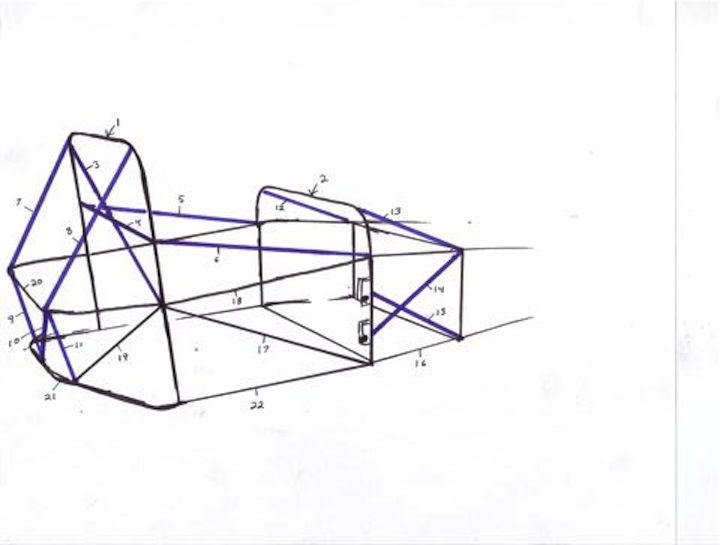

David, 962Porsche, provided a diagram and some comments. I'll put them up later when I get my regular machine going and can re-size the drawing etc.

Here's the sketch that David sent me in an email. He said it was OK to post the picture, so I'll make a small leap and include a little of his text.
with the pick up points for the 4 link bars 14 and 15 I have 3 other ways that could be done . the way it is in my drawing would be the lightest and strongest . I move the cross bar # 3 up to were bars 17 ,18 , 19 and 20 meat . this I did because its seams to be at a better angle and it's now picking up were there are 6 triangles coming together . in the design you sent I can not see how all the bars meat at the base of bar # 1main hoop .
Thanks for taking the effort to send me this. I am basically doing what you suggested for the rear hoop braces. I didn't flip the support tubes in the middle back, just because it looks like they give a little more protection from the rear this way. In your picture your way looks better! I think I can flip them the way you have them anyway because there will likely be another tube as part of the diff mounting - so good protection in the back.
I see your thoughts on preventing the top part of the hoops folding. There is a variation in the drawing that has a high front hoop. I haven't shown the picture yet because it makes the car look like the one in the "Munsters" TV show. I have been putting a lot of effort into making the car stiff and the way the roll hoop braces connect and make a bridge from the back to the front of the car is a big part of that. It has been very hard for me to get those forward hoop braces to carry a load and not be dead weight. So I am reluctant to make those changes in your diagram. The braces for the front hoop top don't have to be the same material, 1" 16 gauge would be enough to add to their strength. These can likely brace the engine compartment as well, I'll try to draw that up soon.
For the same stiffness reasons, I think we have to leave the diagonal that is between the dash hoop legs and the firewall. That doesn't prevent something like your x-brace going in too, and to take those compression/tension loads from the trailing arms would not take large or heavy tubing at all. In my next post I'll show what the model is saying about the concerns on those trailing arm mounts, I've been wondering about them all along.
