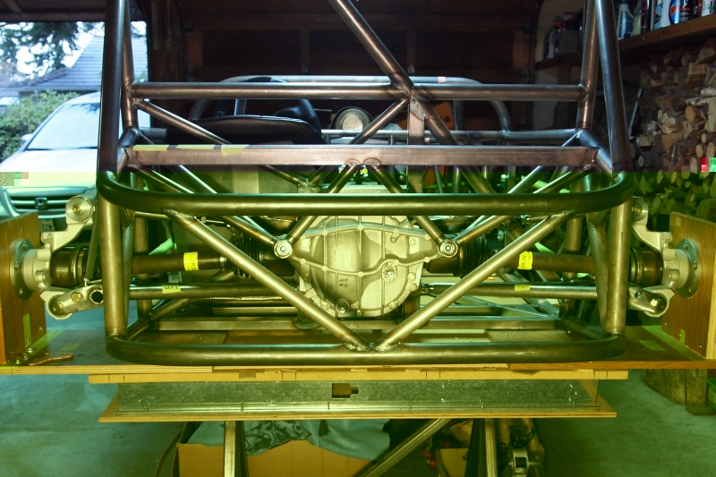

Well with Pat's parts it appeared it would be a good idea to redo the bottom of the dash hoop. It took me awhile to get enough resolve to cut out the previous work for the dash area and install a new bottom tube but here it is. I worked out a way to bulge that bottom tube back and work it into the diagonals on the floor. So now this part of the car can be adjusted by the builder to suite their drivetrain and weight balance choice.

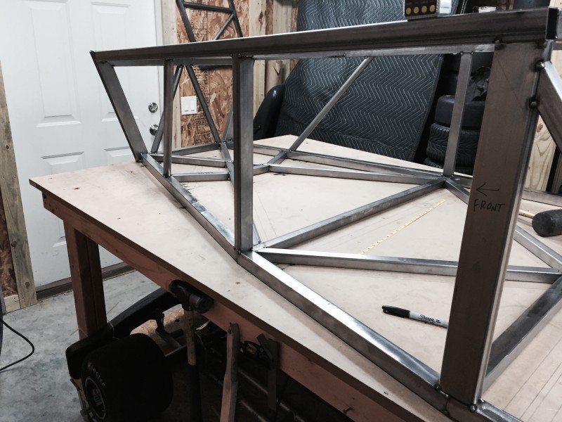

I have another builder that has just started a frame in North Carolina. He is a welder by trade and is building his version in square tube. We are trying to make an easier/quicker to build version. So far this car is planned with a Ecotec 1.4l, T5 and Subaru R160 rear end.

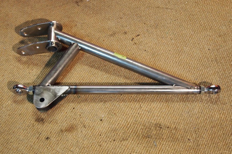

Baby got back. My friend Tom was getting ready to bolt up the rear suspension and I decided to do some more checking on the control arm design. Long story short I landed up spending two weeks doing a redesign on the lower arm to increase margins. Lots of modeling different approaches and trying to get the details right. My FEA (stress analysis) models of the frame now include the suspension arms and you can make them move etc.
Tom was patient and rebuilt his arms to the new spec. They now have 1.25" x 0.095 rear legs with revised and much stronger brackets for the coilover mounts. I think they look pretty nice now too.

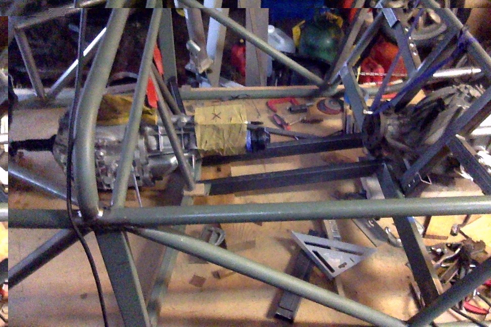

He is now at the part where a set of tires would get him track time, but there is a lot of work left to make it a nice car.
