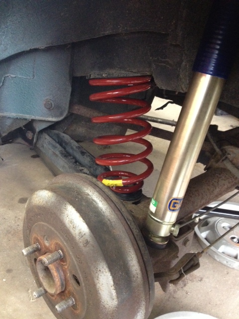

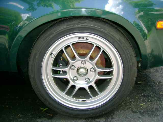

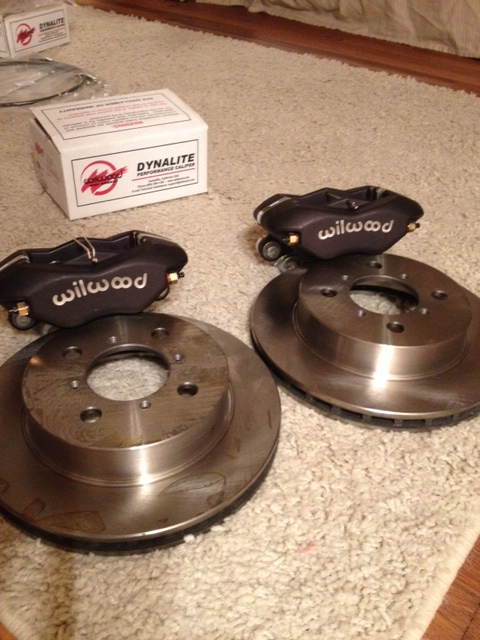

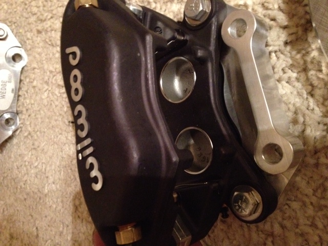

Good bit of work got done over the past month. The suspension and subframe is all swapped, brakes are all in, hard lines, master and master booster are all new.
We have new hubs that allow for 4x100 bolt pattern...gee that is convenient. Much stronger bearings in the hubs as well.
We found a lot of typical problems - one of the rear axle stabilizer mounts had lost a bushing so long ago that it had worn 3/4" oval, a strut mount had 2 of 3 bolts sheared off, the other side had no rubber mounting, the steering column firweall bushing was missing...this thing must have driven like crap!
So anyway, the engine is out, the transmission is out, the rear end is back in with the LSD and new bearings, and it went over to the body shop this morning for a steam cleaning and an eval of the exterior work needed - some bubbling paint over surface rust, a couple scratches and a dent on the rear drivers quarter. Roll bar is getting a harness bar and third angle support welded in and should be done next week.
The 4.1L engine is in build - heads, intake, cam and carb are here - and should be done in a few weeks. The T5 WC transmission needed a rear shaft bearing and that should be done in a week or so.
- GAZ shocks Rear.JPG (126.33 KiB) Viewed 14001 times
- CloseupWilwood.JPG (121.45 KiB) Viewed 14001 times
- frontWilwoods.JPG (132.19 KiB) Viewed 14001 times

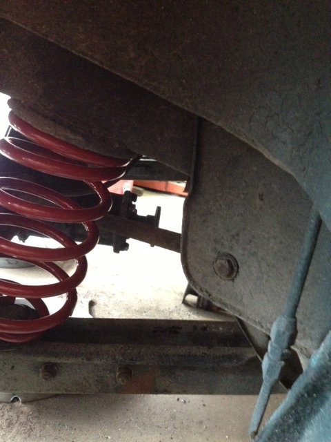

Re: TR7 Build String
Few more pix
- rear subframe.JPG (113.66 KiB) Viewed 14001 times
- ridinghigh.JPG (128.47 KiB) Viewed 14001 times

That sure is a pretty car. You don't come across too many TR7s in that color. Plenty of TR8s but very few TR7s. Those look like the uprated road springs that all the vendors sell. They won't be stiff enough for New Hampshire. They make decent cushy road springs, but not even close to being stiff enough for the track. At a minimum you will need 300# springs front and rear or the car will just lean over. Coil overs on the front and adjuster sleeves above 2.5" coil over springs in the rear will allow you to corner weight the car and set ride height. Front springs can't be any longer than 8" for 300# or 10" for 250# springs or the ride height will be too high. The uprated road springs that I am referring to are in the neighborhood of 125 to 150 X 12" . My typical dry setup for the old NHIS was 300 to 450 in the front and 300 in the back, along with a massive sway bar in the front to keep the car flat. You need to keep the back as low as possible and as soft as possible or else the cars short wheelbase combined with the bumps in the track will bounce you all over the place. Rear steering is fun, but not the fastest way around the track. What did you do for hubs? I use stock hubs drilled to the new 4X100 pattern and the bearing area opened up for one size larger bearings with steel sleeves around the spindle.
