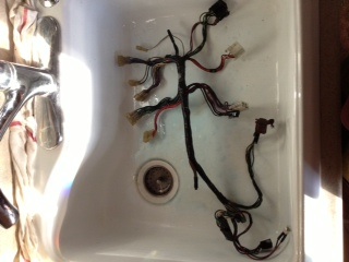

The "hood" came off and was set aside for re-use. The interior was gutted, nearly all the material was scrap, and we saw exactly how bad the floor pans are - totally trash.

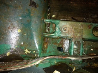

Fortunately the firewall, trunkboard, and side rails are solid, the shock towers front and rear are solid, and the B-post reinforcement joists are solid.

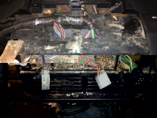

A family of mice had made it in to the dash, so we spent a lot of time cleaning out a variety of disgusting things.

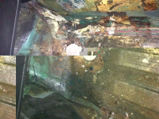

Floor pans are one thing..structural support sections are another! Way too much work unless the car is of great value when done...or it is a labor of love.

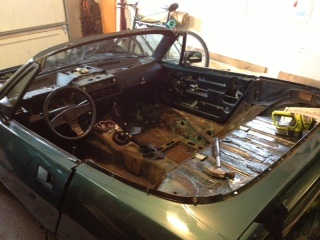

Well, the beginning of taking out the floor pans began today. It's not as bad as I thought, according to Tom Cannon, who visited to give me some much needed direction.
Then we stripped the rest of the dashboard and found one of the mouse homes. Lots of ammonia later, the dash is clean. We also found the nibbled wiring harness which I'll repair tomorrow. New switches and mounts are here, along with ballast resistor, cables for the a.c., and hardware.
The hood (roof to you American car owners) came off in one piece with little argument. It needs a wire brush and reprinted frame, also on tomorrow's let. The bonnet (hood to Americans) came off no problem. We then began disconnecting the engine from the frame and found the next mouse home. Mice are disgusting. More ammonia.
