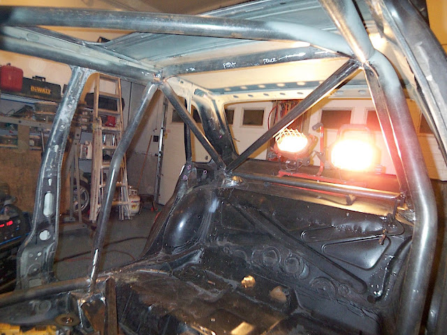

The good news is I will be bringing my car to play in PA, heres an update from todays efforts.

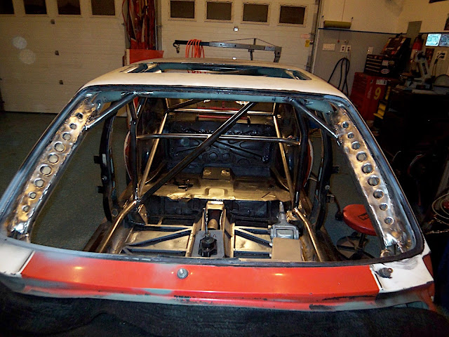

Cage is getting closer to being done
Time for another roll cage update.

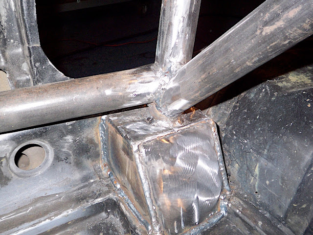

Today I did a bunch of cleanup, added in the 2 sill bars and a load of other tubes.
Sill bars in
Next up was the addition of the diagonal in the rear down tubes, and the rear strut tie bar.
This is how all the tubes in a cage should come together above the drivers head

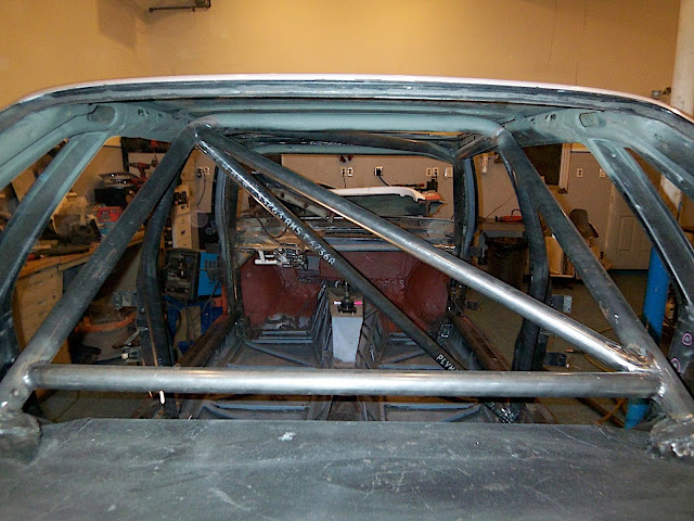

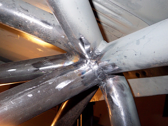

The tube to tube joints are all TIG welded as the cage is 4130, I have been trying to get used to my torch hand controller as using the foot control is a PITA for this stuff. The welds came out OK, could be better but they will certainly do. This shot is right before I added the main hoop diagonal.

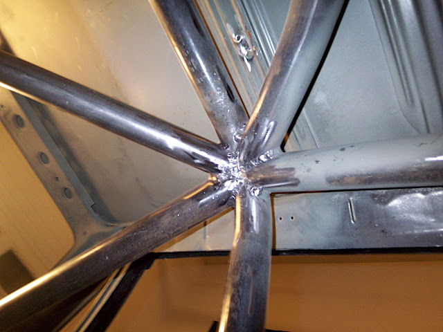

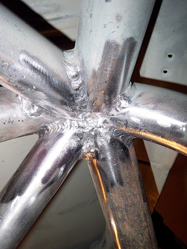

Mai hoop diagonal interface to the spider is a bit complex, I used the fancy pin gauges to get this right.
Here is the spider with the 7th tube added.
And the bottom of the main hoop diagonal

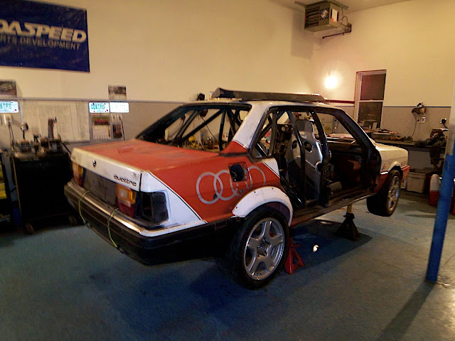

This is really the bulk of the main cage done. There is still plenty to do on it including adding the harness bar, a couple more rear supports and a bunch of gussets oh and of course the door bars.

Cage is about done, except for doorbars, and they go in at the very last moment as working in the car with them in place sucks. Cage gussets are all in, Driveshaft is in, seats are in etc
Exhaust mounted and working on downpipes. I hope to have the exhaust finished this coming weekend, except for the tailpipes but thats just fru-fru.
Next up is fuel system setup and coolant lines, and a few other minor things like lugs to support front bodywork frame, then it can get painted and final assembly can begin.
