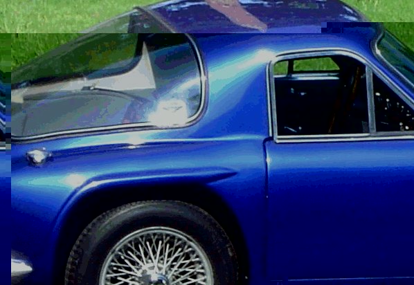

This will be my first year. I have a fiberglass car with nice new paint, 2 years old and I don't want to damage it.
I don't have enough window space to put numbers there, I'll need to affix them to the bodywork.
I'd like to hear some discussion on ways that are being used to affix numbers to the sides of fiberglass cars. What works, what doesn't, what is easy to apply/remove, what looks good, what is safe for the paint, and anything else worth mention.
Thanks, Paul.
Thanks, Paul.

Good Idea. I don't have much room. For reference, the window is about 1 foot square.
Perhaps if I bend the acrylic. I'll keep it in mind.

Paul, if your rear window is glass, it looks like your TVR has enough room for stick on numbers.Stick them on the outside of a clean waxed window and they peal off easy.
