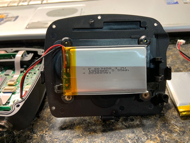

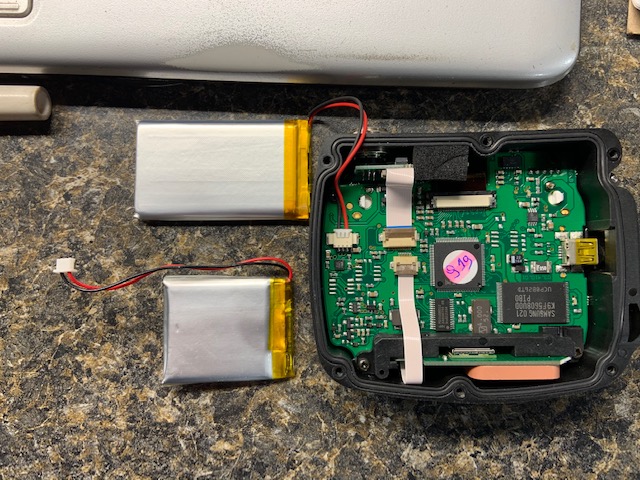

Post by breakaway500 » Mon Nov 16, 2020 3:51 pm
Charging the battery did not fix the problem so I purchased a Solo2 battery,which is a bit bigger, so I had to remove some of the plastic on the inside of the back cover to have it fit. Other than that modification, the Solo2 battery fits fine,(it's the same 3.7V) and plugged right in, and the Solo1 is now working properly again. $20 from Pegasus Racing. If your original Solo battery dies, and you don't want to send it in for the "correct" battery (they will not send/sell you one to DIY...why?) the Solo2 battery (which they will send you..) seems to be a reasonable alternative...:)
