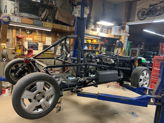

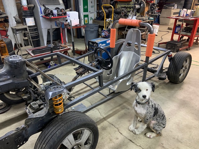

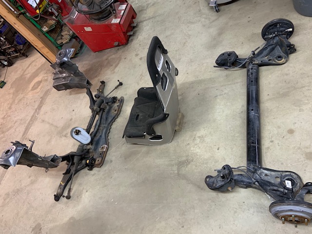

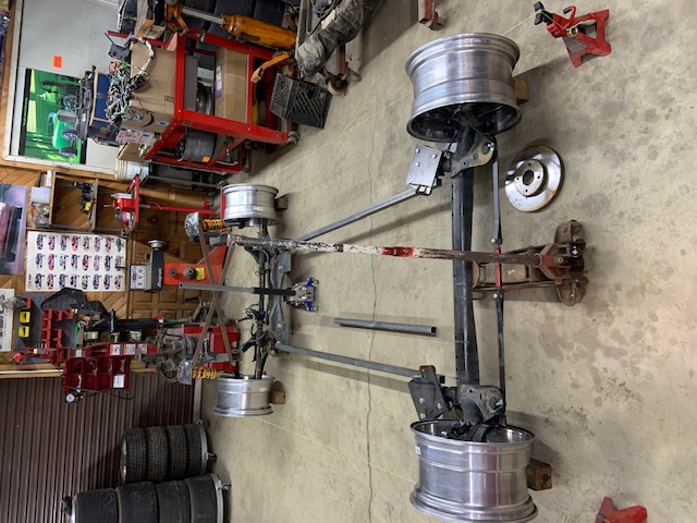

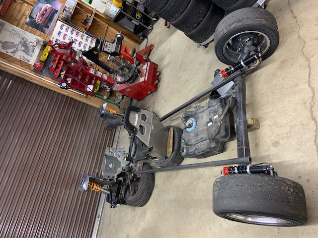

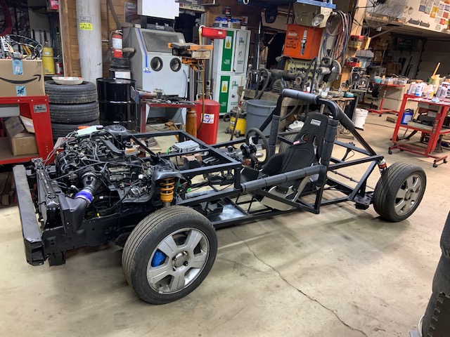

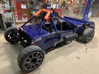

Inspired by others who have built cars at COM,especially Wild Bill McMahon and his V-8 hotrod Austin-Healey..I decided to build a lightweight fwd track car. I started with a 2005 Focus ST which is powered by a 2.3L Duratec 150hp engine and 5spd MTX transaxle. I would use as many components of the donor car as possible.It had a rotted chassis and was free. I kept the front engine/suspension crossmember and the shock towers and front radiator support from the Focus. The rest of the chassis would be made from 1.5" .120 wall EWS square tube. I had the main roll bar hoop bent by a shop. Other than that, all straight pieces, MIG welded.

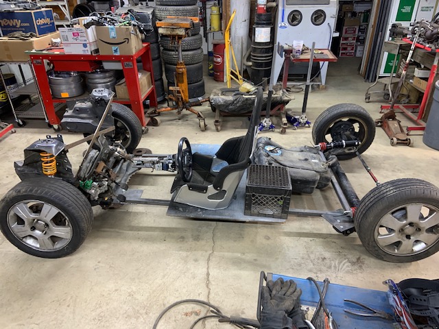

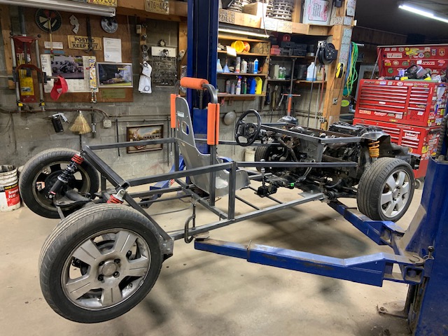

I started with a simple mock up. Then laid down the main frame connectors to get spacing.I then aligned everything square and centered. I then started welding. Once the main frame was solid I could start putting in the driveline and other components and get it on the lift.
I fabricated a firewall and completed wiring and other incidentals. Lots of incidentals..wiring was..interesting. Ford does not want you using their harness outside their cars.

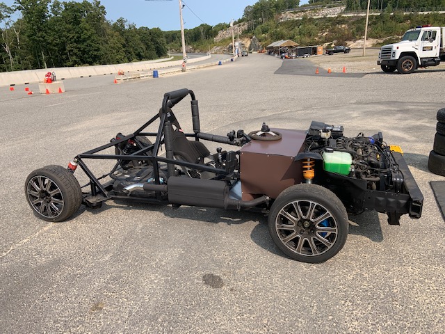

Turned the key...drove it around the yard...and then took it to Whiskey Hill yesterday on it's shake down run. :shock:
Ran some 205 wide tires which were take offs but not corded and proceeded to do a few laps.
No issues..other than the brake fluid reservoir did not like being in the wind and spit at me.
Braking was perfect. Manual steering was excellent and accurate. Ride quality is amazingly smooth! The engine pulled well with the substantial weight reduction.Have not had the car on the scales,but I believe it is right around 1k.lbs. Less is more.
I was pretty amazed how well the car handled and comfortably got into the low 1:50s. With better tires and some aero..I expect high 1:40s.
With my turbo 2.3 Duratec engine...making 325whp... I may get to see God..:)

Last one. My well used tires were going away..but the car felt very stable and wanted more. Not nervous or twitchy at all. NO roll..NO dive under braking..it was very entertaining. Passing a Ferrari made it all very real. I'M...H-A-P-P-Y...I'm H-A-P-P-Y...!! :lol:
I’ll have to work on getting it looking a bit less....hillbilly. Plus aero is important.
Some sort of nose. Must be light. And cheap. Aluminum foil so far wins. Maybe a Lexan bird deflector. 4 have hit me this year. One came inside the students ZO6! It was...feathery..but we pressed on. 😃👍
For all those building..keep at it. Nothing like that first lap in a car you created... :wink:

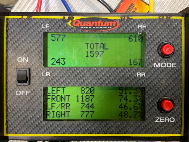

Post by breakaway500 » Tue Sep 22, 2020 9:54 am
Got the MOTA on the scales yesterday..and much to my surprise..it weighs in at just under 1400lbs...without me in it. Heavier than I expected, but steel and iron factory bits add up quickly!
I'll be adding another 70lbs with the addition of two more main hoop support bars (one back and a semi-Petty bar) and some sheet metal. Corner balanced it as bast as possible with what I have. Now if we can have a warm dry fall... :lol:

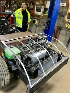

Post by breakaway500 » Tue Oct 13, 2020 6:05 pm

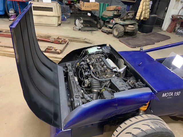

Nose frame coming along. Light aluminum. Riveted, seeing as I have not “perfected” TIG welding.Hsving a difficult time holding my tungsten clearance. Plus that damn foot pedal. Ah well. I’ll practice..sitting down.

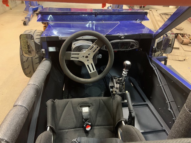

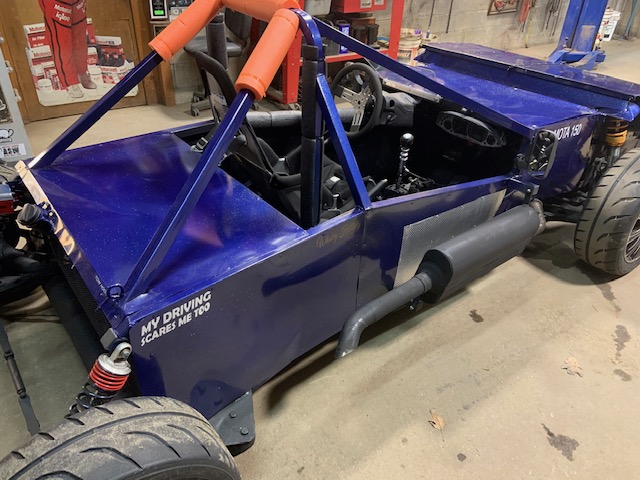

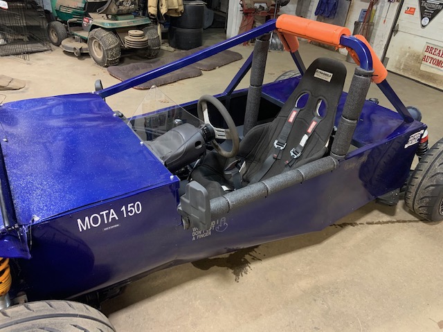

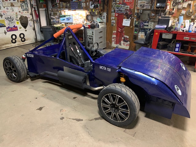

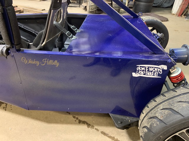

Post by breakaway500 » Sun Dec 27, 2020 4:08 pm
Got my sheetmetal on and painted. I had the car back to the track once more to try out the aero but only did about 9 laps as it was 36 degrees, and my hands were stone cold frozen after 5 laps.....but I did prove out the aero. Everything feels excellent and can't wait for spring!
Yes..it's unconventional and maybe ugly to most eyes...but to me it's beautiful!
I painted it blue..but somehow..after 9 laps..there seems to be gold dust all over the car! The MAGIC of Whiskey Hill! :wink:

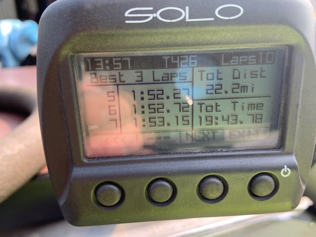

Post by breakaway500 » Sat Apr 10, 2021 7:10 pm
Got back to Whiskey Hill this week and was pleasantly surprised how well the car felt. Aero feels so stable you’d almost think I had a clue ..or at least a wind tunnel. Good guesses and blind faith..works for me..
Did a solid 1:52 (cw) on 225 front 888rs 205 rears and its no where close to ideal at Max grip time. Was going to upgrade the front suspension but it feels fine so I’m not messing with it.
My brake confidence could not be better so 2 channel front brakes alone is working out fine and I am NOT dead. 👍
Even at this power level I Need the 275 R7s up front so power steering going on. Power rack already in car snd just been looped so bolt on pump, hoses and cooler. Adds 12lbs front weight, takes 3-6hp and adds a nother fluid system..so more stuff to leak etc. but necesssry.
