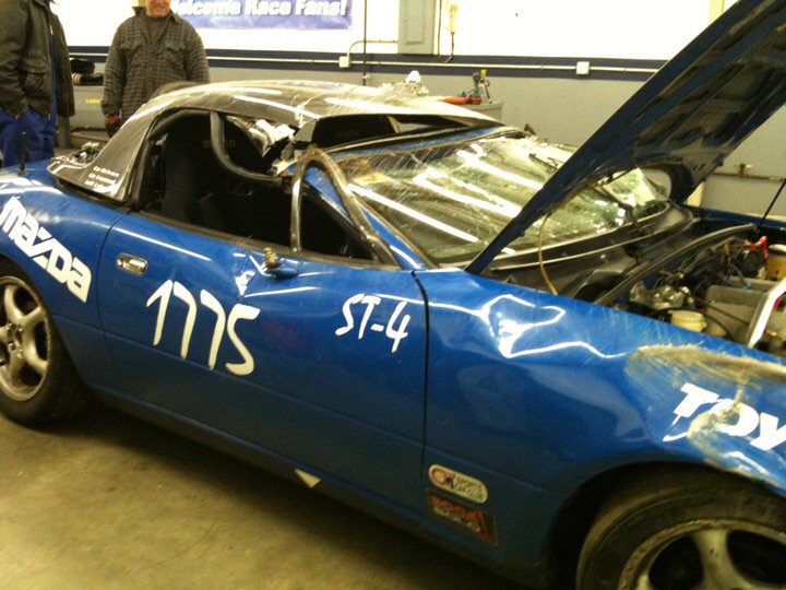

Post by 6PAK72 » Wed Jun 01, 2016 8:55 pm
People ask me why I'm a wheel nazi.
