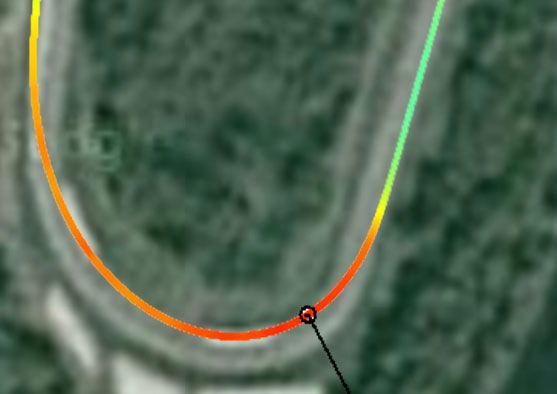

Here's my line through T8, shaded by lateral G's. bluish-green is around the 0 point. Dark red is about 1.2 g's. Satellite images of Tremblant stink!
1. Far-left at T1, like Jeff's line.
5. Patience at 5, like Dave mentioned. Wait, slow, turn-in, go!
7. Same as 5, however less slowing, but slow it down enough to commit to the gas EARLY...and keep it there.
8. Brake late, hair of trail-braking to rotate the car towards the curbing at the first apex. Roll back on the gas, clip the crubing/grass there, but expect to 'blow' the 2nd apex, being a car width or so off. You don't need to be tight there. This is best taken like a single, early-apex turn. Pulling the big lateral G's early lets you get back on the gas with less steering input that much sooner, which extends the back straight. This helps you get a jump-start on that long UPHILL (!) between 8 to 10.
T8 exit to T10. Be slow and deliberate with the wheel. Any extra steering input or vibration is only slowing you down.
T10. Brake later, and less. Every video I've seen is giving up 5-10MPH.
T11. No brake, drop it into 3rd.
T12. Brakes, drop it into 2nd.
T14. Brake later & harder, hair of trail-brake to rotate the car.
If you can left-foot brake, T5, T7, T10. If you can't, don't practice there!

Troy, you are yet again being coy! Actually, your line into T8 is exactly what I'm talking about. Entering a bit faster, the car would have been just slightly wider by the 2nd 'apex', and likely carrying the fastest exit speed of the bunch, but well-done.
