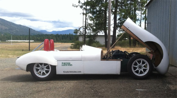

An interesting body for a Locost with half the drag ( twice the power is a good way to look at it ).
Here is a great video of some of the design research and development that went into this. Jack McCornack is the developer and was recently included in the Experimental Aviation Hall of Fame. He designed the strap on gliders parachuters use in a James Bond movie a few years ago.
http://www.youtube.com/watch?v=RU0R_r1yC-g

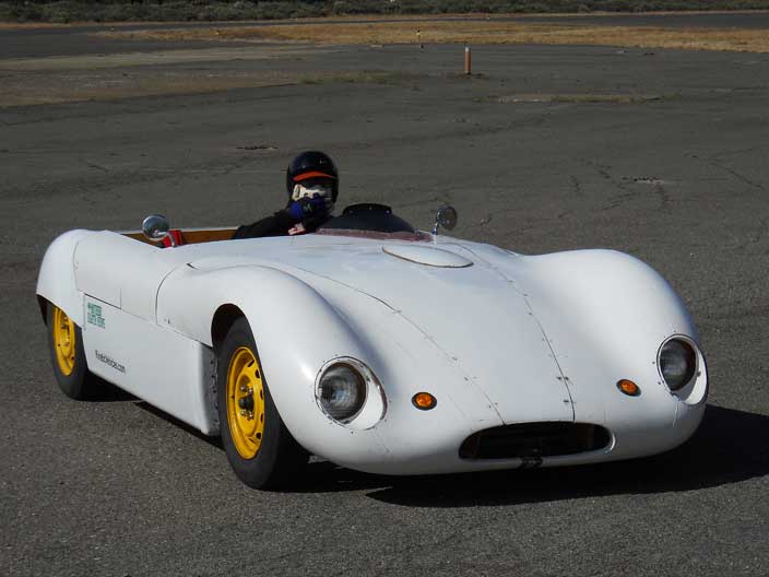

I didn't have much time to write a post above. The picture is to give an idea of what that body work would look like. It started with body work for a Lola Mark I, what you see there is the work in progress to fit it to a Locost. Jack eventually plans to make molds from this and have the bodies available this fall. He has a traditional looking fairing behind the driver now and it looks more finished.
He also sells a lot of Locost parts. This Locost is powered by a 35 HP Turbo diesel and gets 100 MPG, he has entered it in several competitions. He can run it on olive oil for the price of your average car's gas...
http://kineticvehicles.com/
His aerospace company is here and you can see his gliders for paratroopers on the front page:
http://www.kineticaerospace.com/

Yes, I'm thinking open wheel or Seven style, just thought I'd put up those pictures as an option. A Locost style chassis is so generic, you could fit all kinds of bodies on top. You just got me thinking about that a bit when you made those comments about the cost of fiberglass bodies.
So the easiest thing is a Seven / Locost style body. There are several noses available for that and the rest is just simple aluminum sheet. I keep wondering though about some older style roadster bodies, both oval track cars and street cars. The Massachusetts laws recently enacted for kits and home builts seem complicated but maybe are easier for pre 1948 cars? I don't know.
The fellow with the above Lola style bodywork sells several Locost noses including ones that come in pieces that you can fiberglass together to accommodate different height and width noses.He also sells the scuttles the same way.

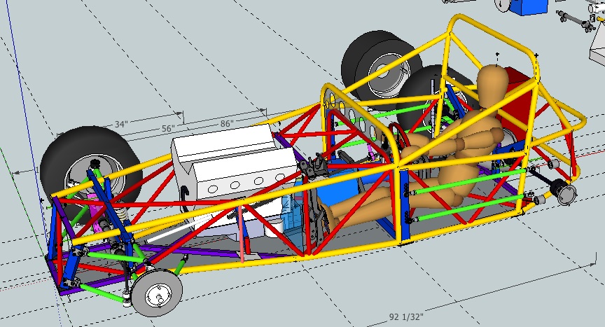

Still pugging away. trying to tie up a bunch of details and get closer to playing with metal. I have a question about driveshaft u-joints that I'll post below. Here's the what the car looks like now. This has the improved engine bay and dash bracing. It removes the cross tubes on a Locost that are often modified to fit various engines/transmissions. Instead the dash is made stronger and the bracing forward from there is well tied together. The dash is now a "Terry Hoop".
I haev placed the front suspension parts and coilover. There is both an outboard and the start of the inboard version. I think the best option for inboard suspension is the bodywork from Jack McCornack shown above. He has removed the mock up from his car and is currently building a set of production molds. He sold the first three bodies for $2500 and the production versions will be a bit more. Half the drag means twice the power, that's a pretty good deal.
I have put in a floor to help tie down some details. Will make a Kirkey seat later today. Moved the rear hoops back a bit to allow a vertical shape 5 gallon fuel cell.
Made up a set of Wilwood hanging pedals and a set of floor mounted Tilton pedals. The Wilwood ones have the proper support drawn, the Tilton ones are just pedals for now. I think the floor mount pedals seem more right for a very low seating position, perhaps the hanging pedals are better for street use.
I made drawings of a Woodward steering rack and also an aftermarket Mustang style rack and also a collapsable oval track steering column.
Working on checking the cockpit sizing etc.

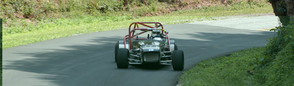

A couple more Locosty pictures. Here's LocostUSA member Heikki winning the "Chase the Dragon" hillclimb last weekend. He took first place overall! By a couple of seconds.
Also another picture of the Lalo bodywork for a Locost. I see from his notes that this bodywork changed the top speed of his Locost from 72 MPH to 90 MPH with a 32 HP motor. He figures that with 250 HP the car should do about 180 MPH. Heikki is also buying a beta version of this bodywork.
