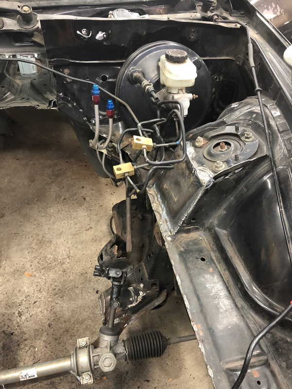

Spent nearly 12 hours of Saturday on homework, so I could finally get into the garage for a bit. Almost went mountain biking instead
Got my shoulder harnesses in, sitting in it, the belts are just under 0, but that is with the seat in its lowest position and this is only the mockup seat. All said and done, I should be between -5 and -10 degrees.
Cut my steering shaft off, the factory column with steering wheel was 12 pounds after gutting most accessories off of it! Weld on 0.5" shaft (might put a small outer sleeve for additional weld, losing steering is no bueno) then the shaft goes through a hemi joint, weld on steering wheel flange, and then buy steering wheel, which are all ridiculously priced....might wait for a swap meet?
Boxed in the strut tower.

Re: My PHD RX8 Build (Because it will take me 8 years)
Kind of changed my stage 1 goal of getting the motor running, to getting the car rolling first. I already know exactly what I want for brakes and suspension, so that at least some progress will be made. Plus from the engine and transmission stand point, any stepping stone of progress I make there is $600+, which I am just not feeling
Crappy picture, but welded in both lapbelt tabs and the 5th point.
Got the steering column together. Its only a 1/2" solid steel shaft with two supports and it feels really stiff, but won't know for sure until I put a steering wheel on it, sit in the seat cranking around the steering making race car noises. If its not stiff enough, easy enough to sleeve over and up the heim size. Also have to cut the wings off the trick tab on the second support.
Made a little bracket for my fuel pressure regulator and built in a little isolation where it mounts to the firewall. Going to have a small section of braided hose between the hard lines and regulator...just because racecar.
Need to change the -8 to -6 and figure out which port to use to go to the fuel rail.
