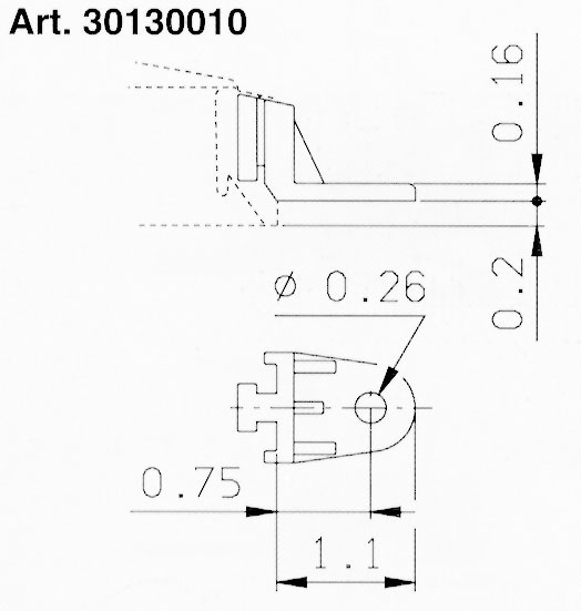

Have any of you used the through radiator type pins to secure an electric fan?
I'm about to install a Spal electric fan and it came with pins. They'd certainly make it a quick and easy install, but I don't trust them. It seems like over time they would damage the radiator. I plan on fabricating some brackets instead. I was just wondering if anyone here has had any experience with them. (good or bad)
Image of pins
http://images.auctionworks.com/hi/61/60 ... c09351.jpg
Technical drawing
http://www.jaycorptech.com/images/product/large/32.jpg
I plan on making brackets like this instead.

They will work well if securely tightened, and if not subjected to a lot of translational shock loads. (Keep the car on the track!).
I have found better results by welding a pair of steel flat bars (1x 1/8") across the radiator frame and bolting the fan to this array. This puts no load on the radiator tube structure- as does the mounting pin system.
It all depends on how you load the structure - a lot of off track excursions will cause the mounting pins to do bad stuff to the rad tubes which are really only there to cool water.

Bill, that's what I was concerned about. I thought that over time the tubes on the radiator could bend an loosen. Then if the fan bounced around it would pinch a tube off or cause a leak. I guess it would also depend on the mass of the fan. I got the lightest one available in my size, 14" @ 2.9 lbs.
