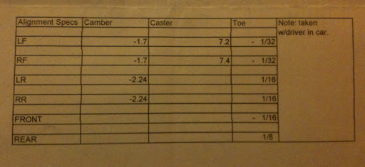

Those alignment numbers look good to me.You could go a bit more camber up frt (up to 2.0) at the expense of some additional tire wear. I like neutral toe at the frt,leaning toward toe in (about 1/16" total)...but that is just my preference.Everyone says toe out is better for turn in..but personally,I can't feel the difference and I will gladly sacrifice some turn in snap for in line stability at 125mph..

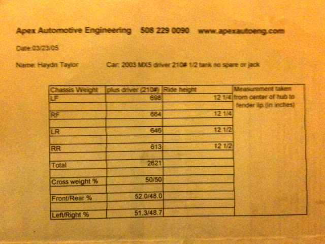

This is the setup Les put on my NB years ago, and I have to say it is absolutely perfect! The car is super neutral and predictable on track, and on the street one of the nicest handling Miata's I have driven.
Take it down to Les and have him set it up for you.

Scott at Fastrack in Peabody can do any alignment you want too. Try going a half degree additional negative camber on both ends. Soften up the front bar too if you're looking for less understeer. FYI, the SM suspension kit from MS uses 700# front springs, 325# rear. Be sure to align the car on new tires or the numbers will be off due to old/used tires (uneven wear across the tread).
