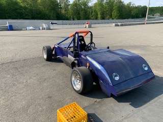

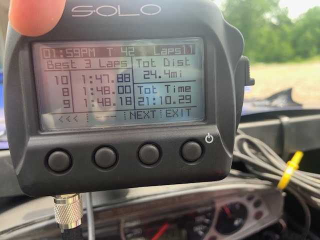

Was back at Whiskey Hill Raceway yesterday with the new and improved Mota. Power steering installed and the 275 wide front tires.
Conditions were great and after a day of instructing I had about 30 mins left to try out the new setup.
The car felt better from pit out. Cornering felt effortless. After a couple of spirited laps I gave it the spurs.
I was amazed to find the car handled my usual entry speeds with ease. After about 6 laps I gave it the whip. Into the 140s I went..and the car still felt eager for more enrty speed..!! No slipping at either end.
About ten laps in I was in the 1:48 range looking at 1:47s. It was very difficult to convince myself to raise the enrty speed faster than what I was use to doing in other cars. Still no slip or movement from the front or rear. Pretty exciting.
With some more seat time at this power/weight level (150hp. and 1620lbs with driver) ) and tire combination (275s/205s) I feel there is another 2-3 seconds left. Then the decision to drop in 325hp remains...
NO issues with anything and the stock 2005 127k mile Focus drivetrain seems to be more than willing to entertain. Ride quality is not bad considering the performance results. I did happen to pass a Ferrari 430 Challenge car..but that's really not my goal..just a fact.

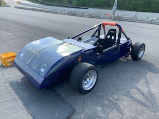

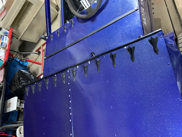

Was back at the Hill yesterday trying out some aero mods,some R7s on the front along with some Hawk blue pads. Better results and more consistent times. I still haven't been able to find the edge on corner entry speeds but I'm working on it. The car is very sorted and no issues with anything.
It's a blast to drive! My $4k investment to date (including tires) has been well worth the performance achieved.
I know it's unorthodox ,but such has been my journey through life...a cross I bear...
The Vortex generators have calmed the sheet metal flapping considerably and my top speed was up 1 mph. (111mph) Not much..but a gain is a gain.
CCW direction.
Whiskey Hill tips: stay off the new white perimeter lines..especially when wet..and don't feed the Turkey Vultures. They will follow you around the track..

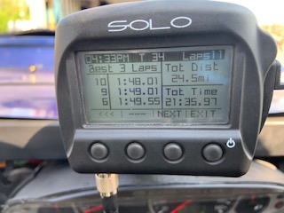

Re: My MOTA build..thats Atom, backwards...

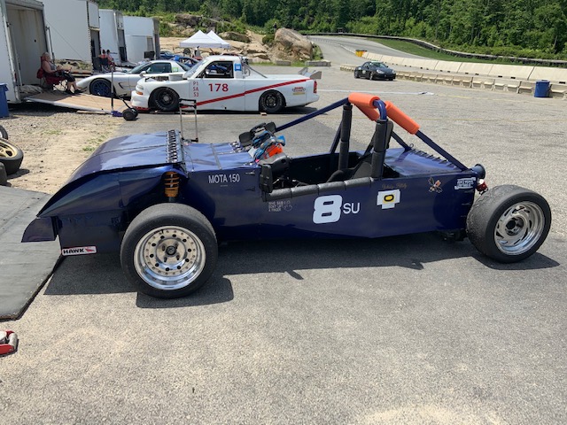

Dreams really do come true. From just a thought to the podium!
The car ran flawlessly all weekend and I ran a respectable 1:48:66 during an official time trial and although no other SU entries..a sanctioned club victory win is a win. MOTA lives.
I want to thank everyone who came by to chat and offer advice. It was good to see everyone once again.
The only time the car gave me pause was loading up on Sunday afternoon...as I turned the key to start it and got just a click.Tried again..click. Once more and the solenoid decided to make contact. The little car just didn't want to leave.
Guess I'll replace that 16 year old 127k mile starter. Hey..it's earned it.

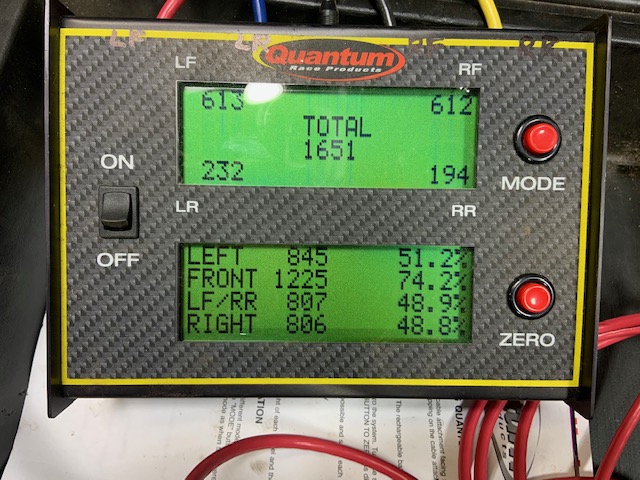

I was able to finally install the new K-Sport front struts and corner balance the car. I could get the corner weights much closer with the adjustable strut bodies and the ride "feels" better (street test)
I'll have it at the track tomorrow to see how it all actually works. I went up a little with spring rates in the front, from 450 to 500/inch, and will keep the rears alone at 145/inch.
I added another hoop support and with all the additional stuff the car gained about 55lbs.
Wow. Is it really 1650lbs with you in the car?

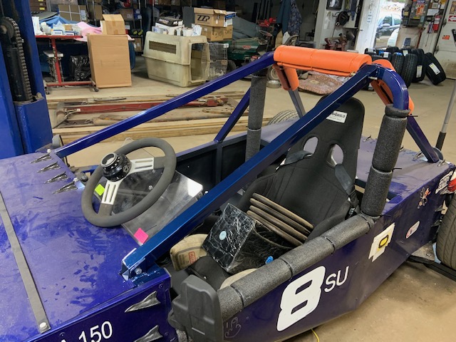

It's actually about 1,665lbs as my front track wheels/tires are about that much heavier than the ones I use on the scales.
The frame is heavy steel as I used 1.5" x.120 wall tubing. Probably not needed but I figured to error on the side of safety.
The next one I build will be lighter...
Picture of the added bar...I'm now pretty enclosed in the car.
