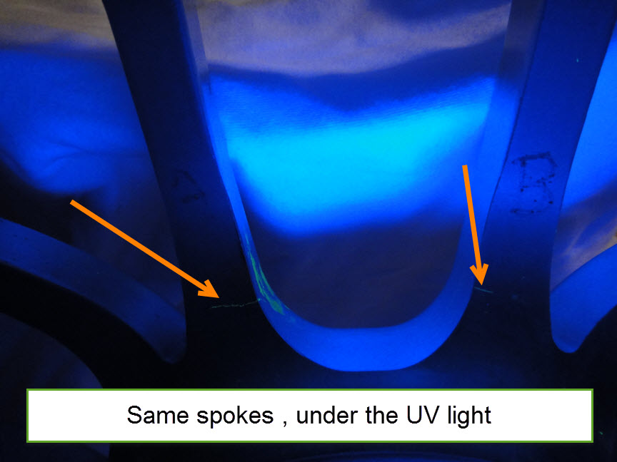

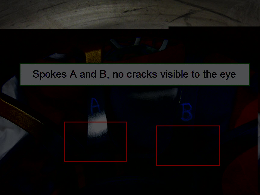

Got the kit for crack detection, and did a test run or two.
Thanks to Dave Wittmer for the wheels
One of the wheels has plenty of cracks, the second has three visible to the eye, but after application of dye and developer, more cracks showed up....
A quick couple of photos:
no light 2 024.jpg (88.98 KiB) Viewed 35102 times
same spokes:
uv light 2 025.jpg (72.6 KiB) Viewed 35102 times
So, If you'd like to have a try, let's set a date
