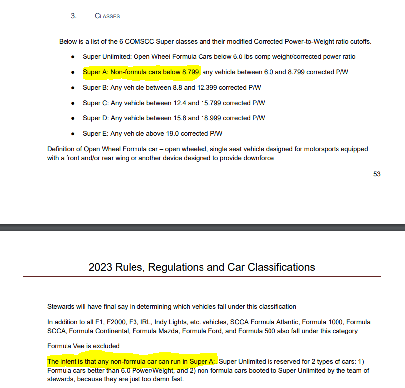

So the power to weight cutoff for Super A is not accurate? This is from the 2023 Super Class Calculation spreadsheet.
2022 CLASS Corrected Power/Weight cut-offs
MIN MAX CLASS
0 5.999 SUPER UNLIMITED
6 8.799 SUPER A

Post by dtlemoine » Wed May 31, 2023 2:14 pm
Those power cutoffs are for open wheel/formula cars. Cars with fenders can always run in SA with no power/weight limit. I believe the rulebook has a disclaimer that if a closed wheel car is deemed "too damn fast" stewards can bump it to U, but they all officially default to A unless manually adjusted.

Dave - exactly correct. Here's the excerpt from the rulebook:
"The intent is that any non-formula car can run in Super A;. Super Unlimited is reserved for 2 types of cars: 1) Formula cars better than 6.0 Power/Weight, and 2) non-formula cars booted to Super Unlimited by the team of stewards, because they are just too damn fast."
You're welcome to run in either SA or SU with no need to dyno in either class (provided the safety equipment is all in-line with the Super reqs, of course). If the laptimes are that crazy, the stewards could always bump to SU but probably premature without having seen them driven in anger at our local tracks.
