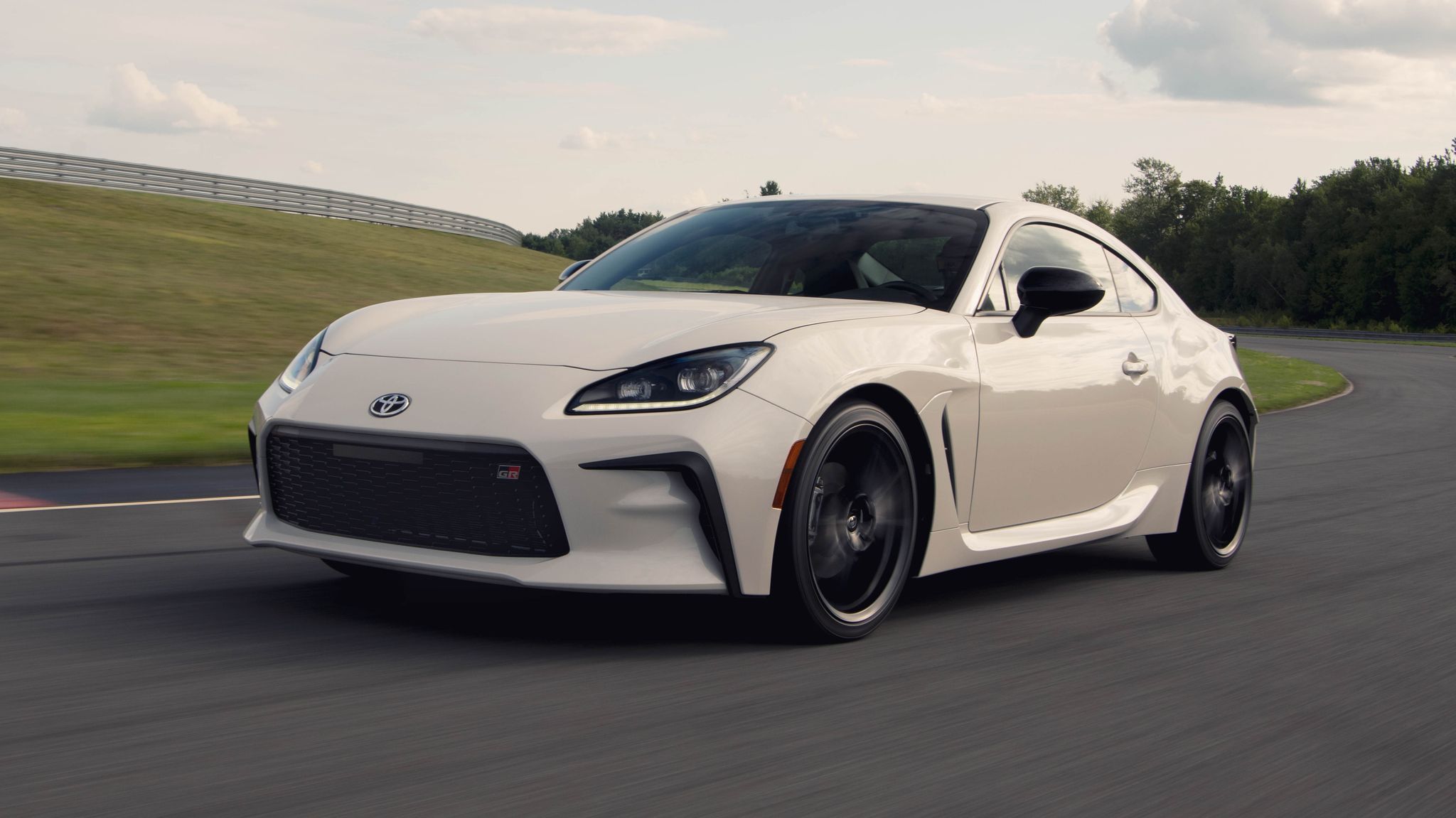

I'm running a Toyota GR86.
This is what the stock front bumper looks like...

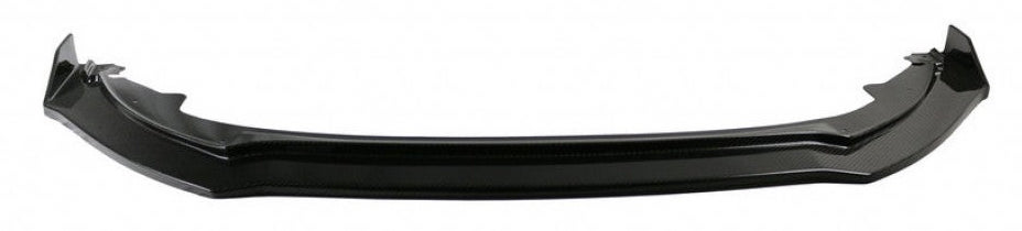

I am looking to add this APR piece (it's a single piece that bolts onto bottom of bumper)

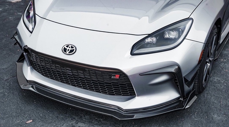

And it looks like this mounted....
I know that that picture shows canards which are separately. I also understand that if it exceeds the 3.5" rule that it'll be 2pt, not 1pt. :-)

This is interesting... there does seem to be a vertical dam component to this piece above the portion that protrudes forward. Good on you for seeking clarification, definitely a gray area.
Suggest reaching out to rules@comscc.org for a formal ruling - this will invoke the entire steward team to review.
